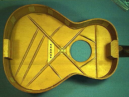

Here's a shot of Gibson L-00 bracing.
CrowDuck
Chris Nielsen
Soquel, CA.

That's a nice bracing shot!
The MIMF does sell a L-00 plan, too. I don't know of anyone else that sells a plan of that type of guitar. It's a 14 fretter.

I have compared a 12 fret and a 14 fret gibson L-00 and what they seem to have done is just shift the whole top, soundhole and bracing back to fit the scale length. I do that for my models and it works well.

From what I read, the famous picture of Robert Johnson he is holding an L-0, aparently not even his, Ma Carter's as the story goes, but someone needed a picture so he grabbed what was there. Of course that was just story When you start talking about Gibson's though you find a lot of inconsistancies, Some have one lower sound bar some 2, some have one finger brace and some 2 per side. Do what works.
